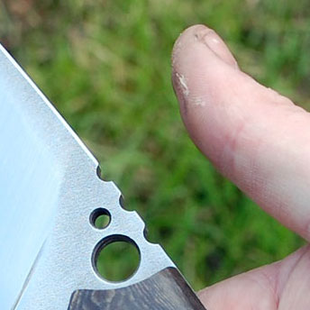

Messagepar GianniLion » 21 Oct 2009 16:32
Here are the final drawings, thickness of blade and handles. There is a Screws drawing too.
In a few days I will start to cut the blades by laser.
I am afraid about the handle finger grow, it is too sharp for me, radius of 1.2 mm

Messagepar oufti » 21 Oct 2009 16:41
GianniLion a écrit:I am afraid about the handle finger grow, it is too sharp for me, radius of 1.2 mm
Then you should either go for smaller or really bigger, I like them like this:

Messagepar christobal » 21 Oct 2009 20:29
GianniLion a écrit:I am afraid about the handle finger grow, it is too sharp for me, radius of 1.2 mm .
The solution (for example) would be to make small spaced notches identical to the MCKF 4 .
La solution (par exemple) serait de faire des petites encoches espacées identiques au MCKF 4 .
