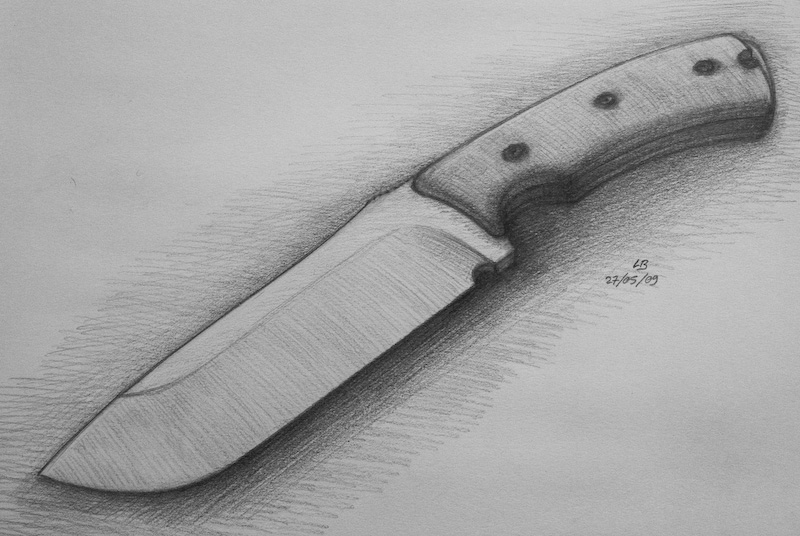

Re: on fait comme MCKF - le camp-knife ? (votation)
Messagepar christobal » 27 Mai 2009 22:48
molletta a écrit:The original design have the finger groove 36.6 mm diameter. Too big, 28.6 in render.
The handle in rendering is 134 mm.
The handle is less angled in render and curve on top of handle in not continues for better ergonomics.
If you do not like, I do design as original .
Ciao Molletta .
Effettivamente teniamo al nostro disegno, si può modificarlo leggermente ma non troppo, ad esempio osserva le modifiche che ho effettuato sul piani . :wink:
Grazie .
Christobal .
Messagepar Thomas » 27 Mai 2009 22:58
Ne pas vous fâcher molletta, mais je trouve améliores les solutions originaux :
poigne inclinée.
bossue sur le dos.
micarta qui couvre tout l'acier
Thomas
Messages: 37
Inscrit le: 16 Mai 2009 14:49
Messagepar Lolo94 » 28 Mai 2009 02:36
molletta, we must pay attention to your suggestions and those of christobal and see what can be retained, and still keep the specificities of our design.
I think that the finger groove must be large in diameter and not too deep, because it can be quite unconfortable during heavy use.
Christobal: your modifications to the handle seem a bit too much to me. It lends the handle to be thinner toward the end and thicker in the middle. Once again for a chopper in seems not to be a good idea for a good grasp, as you noticed. I must confess that I am used to a Leuku knife whose pommel is 5cm at the end, so 3,5cm does not seem too big to me...
I will work on that and make a new proposal tomorrow. ;)
molletta, nous devons être attentifs à tes suggestions et à celles de Christobal et voir ce qui peut être retenu, tout en gardant les spécificités de notre design.
Je pense que l'empreinte de doigt doit être large de diamètre et pas trop profonde, car elle peut être très inconfortable d'une utilisation intense.
Christobal: les modifications à la poignée semblent un peu excessives pour moi. Le manche finit par sembler être plus mince vers la fin et plus épais au milieu. Cela ne semble pas être une bonne idée pour une bonne prise, comme tu l'as remarqué. Je dois avouer que je suis habitué à un Leuku dont le pommeau fait 5 cm à la fin, donc 3,5 cm ne semble pas si gros pour moi …
Je vais travailler sur cela et faire une nouvelle proposition de demain.
En attendant enjoy, le rendu 3D à l'ancienne. ;)
Messagepar christian812 » 28 Mai 2009 14:29
Hé Lolo, en plus de bien manier Illustrator > t'as un solide coup de crayon > c'est chiadé !
Par "évolution", je n'entendais pas du tout faire de l'esthétisme ! Mais bien améliorer l'ergonomie et un peu la technique.
Quelques remarques perso mais qui ont déjà été évoquées par d'autres.
- Ci-après un manche de Hattori Hunter > bien + ergonomique que des plaquettes à l'emporte pièce.
Garde et quillon en moins, c'est proche du projet (quoique l'emplacement de l'index crée une sorte de faux quillon).
Regardez le marteau de votre grand-père et un marteau Stanley actuel > avec le second, prise en main correcte du premier coup (dans le bon axe) et on ne ripe plus sur le clou.
- Les vis de fixation des plaquettes me semblent un peu petites en diamètre (M3 en filet ?) > léger pour un Camp Knive !?
Aussi, mettez-nous de l'Allen plutôt que du Torx > tt le monde n'a pas du Torx sous la main.
- Comment voyez-vous ces vis … filet dans la plate semelle ou traversantes (traversantes moins cher) ?
- je trouve aussi que les arrondis des plaquettes près du ricasso ne sont pas géniales et devraient être traitées comme à l'arrière du Hattori > net et simple.
- Perso, je vote pour le Micarta et pas le G10 > un coup dedans et bonjour les fibres dans les mains.
Ciao
